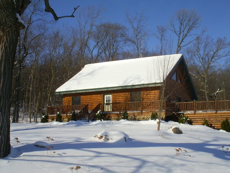

I built a sip House 3 yrs ago just like you talking about.. I used enercept for the whole thing..I used their sip foundation panels, walls and roof.  34x36, with a loft.  I used a main beam in the center. No purlins. 4x 24 roof panel with a I joist for the splines..8/12 pitch.... The whole system works...The roof panels slide together very easy.  3yrs, lots of snow, and my roof is straight and strong. The whole interior of roof is lined with 1x8 tongue and groove knotty pine......See attached pic....
....Jim....
