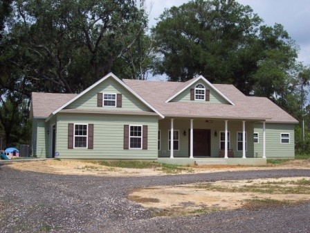

Larry; Can't really put my finger on anything in common; the attached photo shows the finished home that is not on our web site yet |
Attachment: boltin 001.JPG

It's a beautiful home indeed, but what is the difference between this and a stick built home cost wise? What systems were directly effected by the use of steel SIP's? I think these were the questions that started the thread. If you had built this house with conventional methods, would there have been a time difference?

Don't know what the difference is exactly all I know is we where bidding against 2 stick builder and we came in with low bid This system saved a least 3 weeks labor.............. and framing, insulation, dry-in, soffit & fascia where all done at one time as a result of the steel SIPs Since you accomplish several trades all at once you also save the time and agrivation to schedule trusses, insulation and soffit/fascia, plus no crane is necessary to set roof |

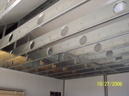

Nice house, Chris. Is there living space behind that window at the top of the gable on the left side of the facade? Did you just hang steel floor joists from the tops of the side walls to create it? |

Posted By Jelly on 02/27/2008 3:38 AM Nice house, Chris. Is there living space behind that window at the top of the gable on the left side of the facade? Did you just hang steel floor joists from the tops of the side walls to create it? Jelly, There is a storage loft above the garage . the following photo shows steel joists as plywood deck is going down. Yes the joist are hung from a receiving channel, that is attached to the wall panel skin and clear spanning 24ft. across garage. The dormer over the main roof is fake |
Attachment: boltin loft.JPG
| Chris Kavala<br>[email protected]<br>1-877-321-SIPS<br /> |
