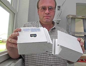

28 Mar 2008 05:51 PM
Seems like steel skinned SIPs are making more sense with no thermal transfer thru splines or studs?

28 Mar 2008 07:35 PM
Posted By cmkavala on 03/28/2008 5:51 PM
That is a 'spline' issue. Many OSB SIPS offer a connection method(spline) that is not thermally conductive.
