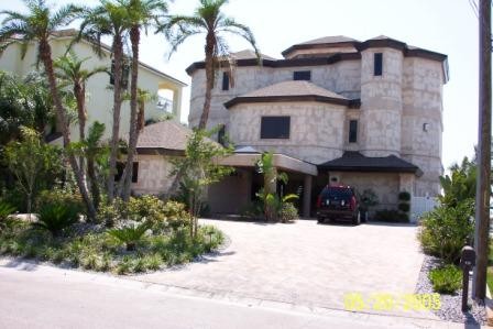

Your builder needs to get out of the stone ages .......SIPs are utilized for very complicated designs and are well received by building departmants, we build in hurricane zones every day
This is not a box..................
Attachment: Driftwood Drive 4, Palm Harbor.JPG

Chris, that picture is a bit fuzzy, but it looks more like ICF than SIP to me.  Is it a SIP roof on ICF walls?

The net-zero home I visited is in Boulder, Colorado, a pretty cutting edge place for green building.  I was also surprised that the building department made them add more framing - isn't this system suposed to come engineered?  The county where my house is going has only had a couple of SIPS homes, so I'm not sure how they will handle it.
Are there windows around the back of this home in the picture?  I have big window walls to deal with because of the views from the lot.  And, although there are a lot of angles, it does look like the second floor mostly stacks over the first.  Mine is significantly more complex, so when does the complexity make SIPS a bad choice?
rnortman;
is not fuzzy its steel sip over redirion frame, with a synthetic stone glued directly to the skin, view progress photos at..
http://southernsips.com/driftwood.html
