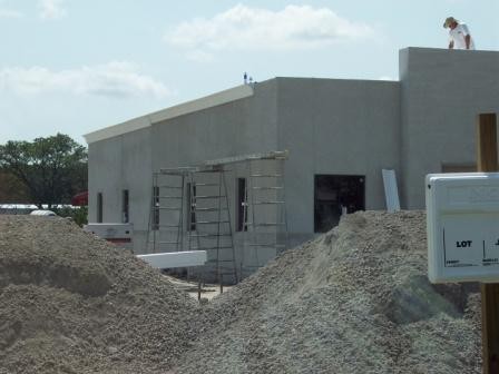

we prefer paper backed lath and traditional 3 coat stucco (7/8" thick)
Attachment: Monroe 001.JPG
