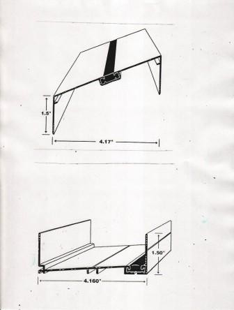

Alton;
There are thermally broken channels available for metal SIPs as shown below, but in the southern climates is totally unecessary
Attachment: Scan10006.jpg

I did not know that thermally broken steel channels were available.  The home I have been consulting on in Florence Alabama used steel channels for the metal AC Tech panels.  Panels were used for the walls and the ceiling.  A regular wood-framing crew installed the panels with the assistance of factory personnel for the first day.  Very simple and fast installation.  The framing crew now wants to build more homes with metal panels.
