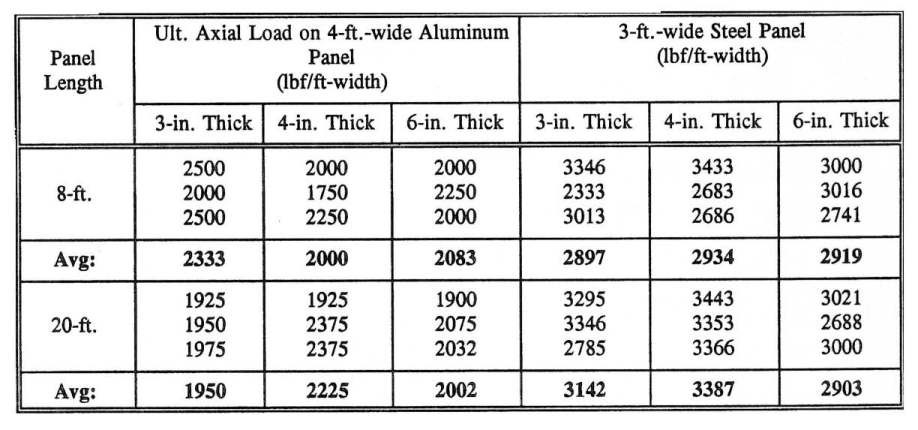

This may be a little off topic, but here is a pic of a standard axial load test done in the horizontal on a metal sip, which as a designer I am more experienced with. If you look closely, you will see the end of a metal rod placed between the 2x4 plate and the testing machine in line with the upper skin. This puts all the axial load on the upper skin and then they test to failure. Richntiff, as an engineer I thought you would find this interesting.

SimonDUser is Offline
Posts:113
28 Jan 2009 09:23 PM
The concept of this test applies to my assembly detail in that if the inner skin of the SIP ends up taking most of the axial load of the wall and roof, that is how the axial load figures a company posts for there panel were determined in the first place. Just food for thought. Personally, I think the tests they do on panels are too conservative and do no reflect the 'real' strength of SIPs.
