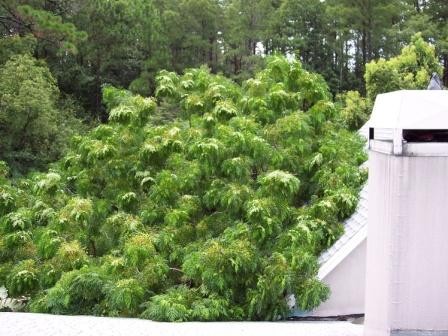

mf071609;
Last July a 70 foot tree fell on the back of my own home, did not penetrate the skin, sustained only shingle damage and according to the tree remover it was bearing the full weight of the (upper portion)  tree
Attachment: tree Damage 009.JPG
Attachment: tree Damage 013.JPG

Holy sh*t! What kind of tree is that? The first year that I owned my house in Northern California, a single branch of one of the 14 80' tall Redwood trees fell onto my utility wires. That one limb, about 12 feet long, was sufficient to snap off my utility mast. My next door neighbor wasn't so lucky, one limb fell through her roof. Made about a foot wide hole in her living room. And then down the street, a tree up the mountain from another house fell, and demolished one half of the house - fortunately no one was at home at the time.

That is a ChinaBerry tree, on my office addition, my wife and I heard it as it start ed to come down, sounded like elephants on the roof.
