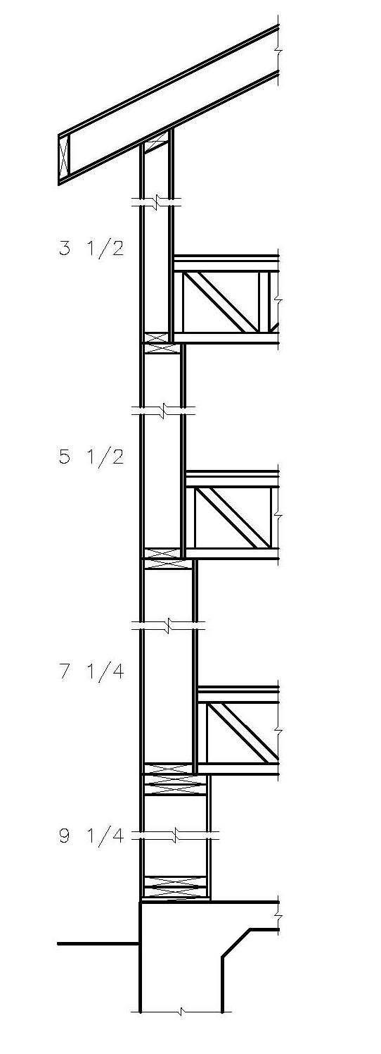

Thought about this concept for a while. Graduating the wall panels as you go up to create a ledger for the floor system and to reduce weight. The first floor wall SIPs could have heavier engineered lumber for splines/plates and be moment connected to the foundation and the reinforcement would get lighter as you went up. This wall/floor configuration is very rigid and gives the floor system the bearing that it needs. This is just a 'raw' concept. There are many issues to consider such as thermal bridging, fire code and such.

29 Aug 2009 06:54 PM
Simon,
I see that you have only 2" of bearing for the floor trusses.  A normal floor truss usually has at least 3" of bearing.  I believe that a bearing can be less than 3" but I thought the floor truss had to be reinforced to do so.  What are your thoughts about this.
SimonDUser is Offline
Posts:113
29 Aug 2009 11:47 PM
Alton,
I guess my drawing implies wood construction and therefore the use of wood floor trusses. Bearing depends on load, span, deflection limit, on center spacing, design of the truss end and method of attachment, so as long as these variables are taken into consideration two inches of bearing is not unreasonable. I would probably go with some kind of light gauge steel framing which would be lighter and can tolerate less bearing. Actually, I drew my concept in 'wood frame', but a system in steel with steel SIPs is the way I would go. All your framing members could be the same depth and you could theoretically just vary the gauge of the steel, lightening it as you ascend.

You can hang the floor trusses on the inside of the walls without any bearing on top of the sips or place the trusses on top of the SIP below and under the SIP above giving it full width bearing. I can not see any issue with the trusses.
I am curious if you believe there is a need for larger SIPs at the bottom, or used them to create a ledge for the trusses? According to the specs it looks like 6.5" SIPs would be strong enough to me.
