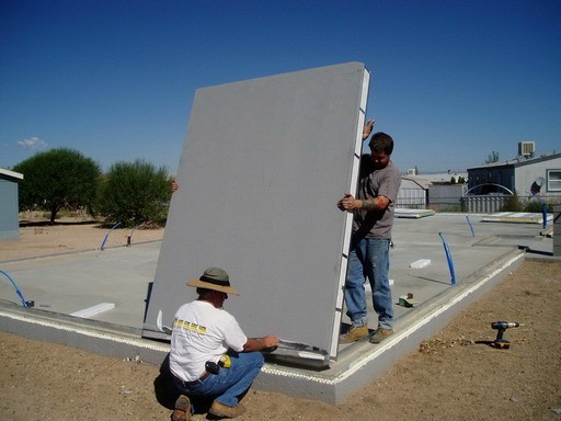

Why anyone would use OSB Sips is beyond good reason. Builders should check out this system and seek out the product ASAP. http://ow.ly/q34u
Attachment: GBSI-5a.jpg
