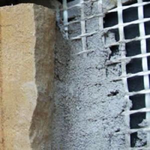

First apply diamond mesh with sheet metal screws, the proceed as required by your material of choice supplies/manufacturer.
Attachment: step_4_475_300.jpg
