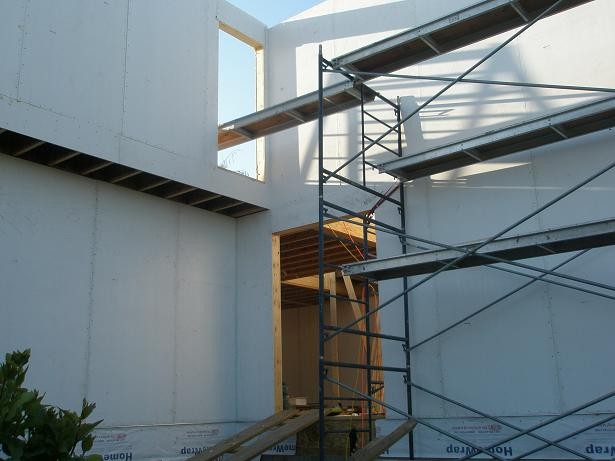

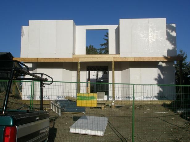

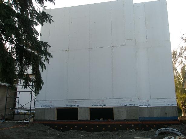

Just posting a few pictures of our Magboard SIP home that I was asked for, roof trusses should be here Monday! Looks like I need some windows. Sean
Attachment: SIP small 4.JPG
Attachment: SIP small 10.JPG
Attachment: SIP small 9.JPG

About 9000 screws! Make sure you get a good quickdrive and the screws have to be coated so the magboard doesn't break them down. I used enerfoam adhesive as well. I kinda thought the drywall type screws weren't going to be strong enough until I had to tear a panel apart, that foam really bonds. Sean
