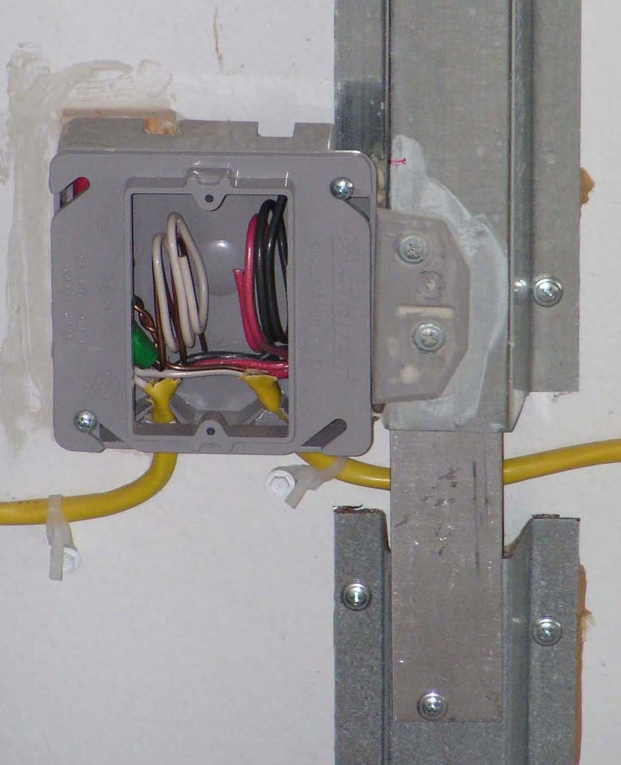

What out for commercial boxes they are designed for 5/8" thick drywall.
Attachment: Wiring1.jpg
