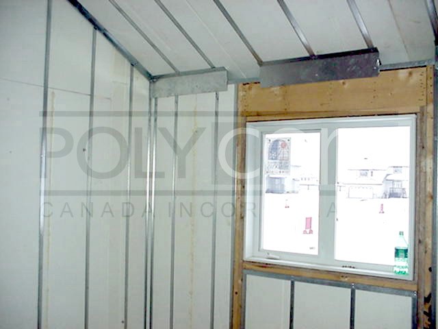

Here is an updated photo of a Polycore build. The image below is about 5 years old and shows a wooden header above the window. Polycore Canada Inc has worked hard to adapt our product to eliminate all thermal bridging and reduce the use of lumber. Notice the use of a metal lintel plate replacing a conventional wooden header.
