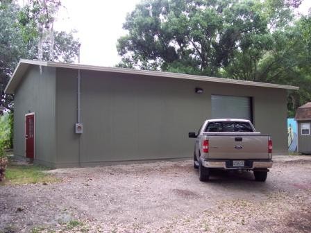

caulked and painted walls on a commercial building in Tampa.........
Attachment: Franklin 001.JPG

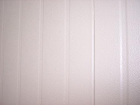

08 Oct 2008 09:57 AM
It would open up even more aesthetic possibilities if the steel SIPS panels were available in something other than the white shadow-line (I think that's what it's called). Can you get them in a smooth finish? I'm guessing the cheapest option though is the one that's readily available.
What kind of paint is on that green building?
08 Oct 2008 10:01 AM
Posted By Jelly on 10/08/2008 9:57 AM
Panels are available smooth one side, owner painted building themselves, they used a latex made for metal siding, available at home depot
I personally like the shadowline, better than smooth
Attachment: Franklin 003.JPG
Attachment: Franklin 004.JPG

Chris, I assume shadowline refers to the lines which simulate vertical siding, or does it refer to the dimpled orange peel texture? Wish I could see one of these things in person. Do you have any pictures of the smooth finish? I think it would look good with a metallic paint, like an ice blue Cadillac or something. One could even apply it in a couple of different values and end up with something sort of like tlynch's pic at the top.

the attached link is using smooth http://www.ntm.org/don_woody/photos.php?img_id=24183&category=Building+our+house
the shadowline is the light 1/32" groove, the light OP texture is commonly refered to as "stucco embossed" in the metal panel industry
