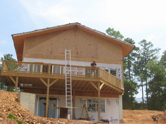

I am owner/builder of a three story (including basement) lake house in central/north alabama.  The basement is ICF construction, the main story and attic are SIPs.  Roof panels are 10 inch SIP panels at a 4 pitch.  Dimensions are basement 34 X 24 and 1st story and attic 34 X 26.

That sounds like a heck of a price for the geo! How many tons total? You mentioned that you did ICF from foundation to roof but it looks like the rear is covered in OSB? Is it a private lake? I've always wondered if the coils were put into a public lake....what about the fisherman?....I'm a BIG fisherman....:).......The coils could get pulled/damaged with lures/anchors??

I believe this a three ton system. The lake is public and managed by Alabama Power. They are very supportive of this technology on the lake. I did ICF only in the basement, three walls, and did SIPs for the rest. The coils would end up under the dock and hopefully won't pose a problem to the fish or the fishermen.

PS  Thanks for correcting me on the ICFs, I edited the opening post to show SIPs.
