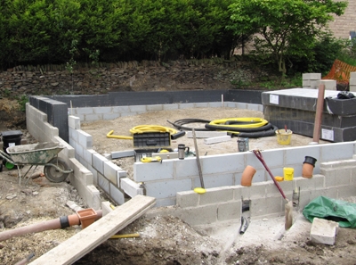

At Denby Dale we are using a combination of details to minimise thermal bridging within the foundations and floor, illustrated in the sections we supplied with the last blog. The cavity wall goes right the way down to the foundation strip, which inevitably results in a thermal bridge where heat is transferred from the solid concrete groundfloor slab through the internal leaf of the cavity wall into the ground and strip foundations below. To minimise the effect of this we are undertaking two key measures.
Below the slab level we are using a lightweight aerated 7N/mm² block, which doesn't transfer heat as readily as the standard concrete block.
Unlike typical foundation wall details, we are also ensuring that the 300mm insulation in the cavity goes right down to the strip foundation, so that any heat lost from the concrete floor slab will have a lot further to go.

Progress is relatively slow because some of the team are finishing off other jobs elsewhere. To be honest I'm not worried, as it means we can pay particular attention to the detailing - Jude, Andrew and Callum have been doing a wonderfully neat job. We're building the walls from foundation strip up to the floor level. We've taken delivery of wonderful looking polystyrene slabs (300mm thick). The polystyrene is being cut in as big as slabs as we can manage, so that the airflow in the cavity will be an absolute minimum.

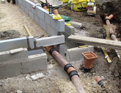

At this point of the build, we need to take into consideration all the services coming into the building. To minimise thermal bridging and airtightness problems, we need to bring drains and services such as gas, water, electricity into the building in a careful manner. Our aim is to interrupt the thermal envelope as little as possible and to have services going into the building in positions which are easy to make airtight. To help minimise thermal bridging, we are bringing the drains in under the slab, rather than having exposed soil vent pipes outside coming through the wall. The gas and electric supply will have to come through the cavity into meter boxes, but they will be in such a position that we can maximise airtightness by using grommets bedded into the wet plaster.
