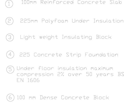

Excavation has gone very well and, thankfully, to budget and with no surprises. We've stripped the site, leveled it and a local farmer has taken the spoil to make use of it. We've excavated the trenches and have added the concrete, which is the same as any strip foundation apart from being wider because of the thickness of the walls - 225mm thick and 850mm wide. Kirklees Building Control have visited and approved depth of foundations.

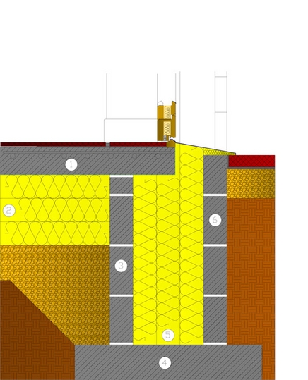

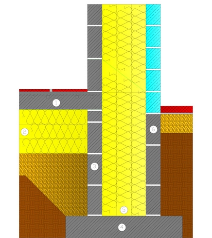

This week we will be getting on with the footings and starting work on the blockwork substructure. After we've built the blockwork around, we will then put in hardcore (crushed stone) in 150mm compacted layers as normal. On top of the hardcore we'll be putting in sand blinding, insulation (225mm of Knauf polyfoam), damp proof membrane, followed by reinforced steel mesh and spacer blocks.
After that, we'll pour in the concrete (100mm) with a power-floated finish - ready to receive tiling or engineered timber flooring. There is nothing unusual about this - it is the simplest sort of floor you can have. The only Passivhaus detailing to this part of the build comes with the way we detail the concrete slab at the edge and the inner leaf blockwork specification.
The slab will be poured across the top of the blockwork inner leaf to minimize the subsequent shrinkage cracking between the wall and floor elements, an area that we identified as a major airtightness problem on the Longwood House we built in the early nineties. The blockwork below the slab will be built of lightweight insulated blocks such as 7N/mm² Celcon to help to minimize the only major thermal bridge in the build.
Hopefully the two sectional images of foundations below will help illustrate this. They show a typical section through the foundations. The second one demonstrates the added complication of an external door threshold.
