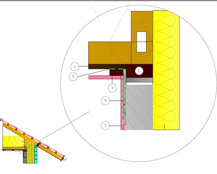

The roof trusses are now in place, so we are concentrating on the important airtightness detailing at the roof and wall junction. Our airtightness barrier on the block walls will be traditional two coat wet plaster. As concrete blockwork is not airtight, dot and dab plasterboard with plaster skim would not perform unless the blocks have a sand and cement parging coat (which rather defeats the object).
For the first floor ceiling we have used 18mm OSB board (18mm is deemed airtight) screwed up into the ceiling binders of the timber trusses which are at 600mm centres. We also wanted to use its structural properties, as 500mm thick mineral wool in the horizontal ceiling would tend to make plasterboard on its own sag. The butted joints of the OSB are taped with specially designed Pro Clima airtightness tapes derived from the automotive industry. Importantly these tapes, along with associated membranes and mastics, have to perform for the life time of the building.
To help achieve the high airtightness levels required, the Denby Dale Passivhaus has been designed to need minimal puncturing of the OSB barrier. Electric cabling will be in the 25mm void created by battening and the plasterboard finish, with the timber batons screwed up into the OSB board. Any fixings through an airtightness membrane (eg a screw going through the OSB board) are deemed to have closed any rupture, provided it is done tight. The clamping of the baton tightly with the screw is deemed to have closed off any interruption of the airtightness barrier.
In addition there will be no trap access hatch as we are putting an external access in the gable end, and all internal block partitions are completed up to the OSB and not all the way up to the trusses.
The junction between the wall and the OSB board is taken care of with another type of Pro Clima membrane taped to the OSB and masticed to a pre parged strip at the top of the blockwork (shown in green on the diagram). Metal lathing gives a key for wall plaster.
Measures to obtain airtightness at wall and roof junction
diagram
1. OSB board
2. Pro Clima DA-S airtightness membrane
3. Timber baton
4. Parged blockwork
5. Two-coat plasterwork onto expanded metal
6. Timber wall plate
