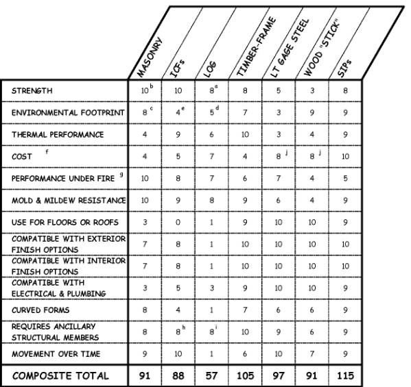

At last we come to SIPs. The physical and mechanical characteristics of SIPs are best found by contacting the various manufacturers listed at SIPS.ORG and SIPWEB.COM. Suffice it to say here that they are structurally and thermally superior to most options discussed above and also feature a remarkably small environmental footprint. Our Martian friends carefully and methodically constructed a matrix to enable them to exercise proper judgement about what they have learned about the various options in front of them. Down the left side are performance categories, each with a value from 1-10, with 1 being the worst value and 10 representing the best. Across the top are the Column Labels of each of the candidate Systems.
Please note that most of these ratings are highly subjective, reflecting my personal assessment of value relative to performance. I do not know of any objective testing that assigns importance to various performance categories; for example: whether or not it is important for the building to be of fire-resistant construction beyond code requirements is a matter for each individual to prioritize. The values in the "Evaluation Matrix" have relative significance rather than absolute significance. These are not scientifically derived, but empirically - based on many years of working with all the systems listed in the capacity of an architect.
NOTES:
  1. Assumes Structural SIP skins.
  2. Assumes adequate rebar for racking & seismic resistance.
  3. Assumes minimum Portland cement.
  4. Assumes logs from prime trees.
  5. Due to Portland cement.
  6. Life Cycle Analysis.
  7. Products of combustion and resistance to combustion.
  8. Rebar throughout is standard.
  9. Assumes small openings.
  10. Framing upgraded to equal SIP thermal performance. ( R and infiltration )
So now we have some kind of "scorecard" based on the evaluation matrix. It obviously can not be used to guarantee a positive aesthetic outcome - one is still on one's own for that one - but it may prove helpful to the Martians in aiding them to decide that SIPs would be the most "logical" choice (as Spock would say) providing that non-combustibility is not an absolute criteria.
