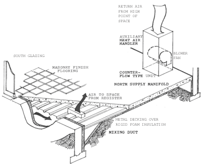

    3. CONSTRUCTION
    Investigation of concrete block floors with respect to material and labor costs proved disheartening. Industrial metal roof decking provided the answer. In simplest form the system is built as follows. For a simple east/west rectangular plan with south glazing (a common enough plan form) the grade is first prepared for a concrete slab in the usual fashion. Rigid foam insulation is carefully laid down over the final layer of screeded sand. I most often use two-inch thick bead-board but polyisocyanurate foam board is recommended for those concerned with toxic combustion products. Most sources advise against placing any insulation under a direct gain slab, but because the delta-T is now substantially increased in this system, insulation is required in order to prevent large heat losses from occurring.
    Fig. 1: Alternate manifold layout.
    Running east/west along the inside of the north frost wall install a vertical foam board and, as you approach this edge, excavate and turn down the horizontal foam boards at approximately
    45 degrees to make a "vee" trench. This manifold runs continuously along the north frost wall and is proportioned like any proper supply duct tree. Along the south frost wall install the insulation in a like manner except the "vee" trench mixing duct need only be eight inches across the top. The steel decking is merely a form and thus is the cheapest grade I II inch type "B'. roof deck, 22 gage, painted finish. It is laid in two lengths lap-spliced in the middle allowing them to be spread tightly against and slightly into the vertical perimeter foam insulation and then locked with either tack welds, pop-rivets, or self-tapping duct screws. The concrete is poured over the decking to a thickness of about six inches to the bottom of the rib. The slab is reinforced with 6'.x 6"/10-10 temperature welded wire mesh and the necessary re-bars to span the manifolds. 1 1/2 inch flats on the bottom of the decking six inches on center bearing on 25 p.s.i. foam provides 900 pounds per square foot safe total loading. Sinuous decking would probably sink into the foam.

    Fig. 2: Most common construction of plenum floor slab. (Larger image)
