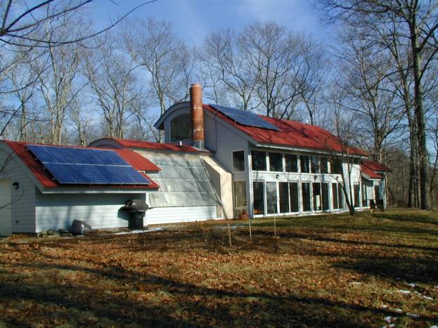

My Long Island New York home with overhangs that provide 100% shading of south-facing glass on the summer solstice. A Southern home might have larger overhangs that provide 100% shading for 6 months or longer.

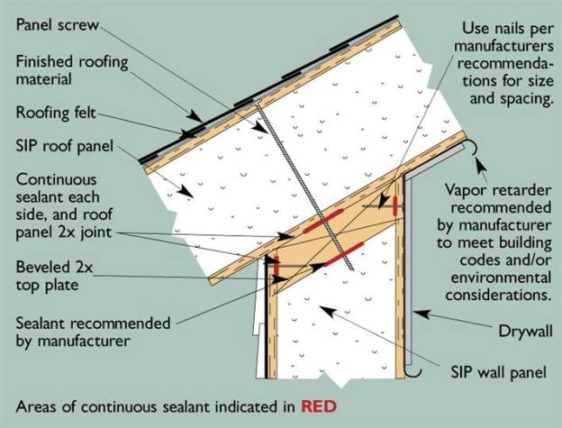

Panel screws have a minimum withdrawal resistance of 600 pounds each without additional washers under the screw head. Where this SIPA illustration shows nails fastening the wall top plate to the wall SIP skins, we always specify screws.
Roof overhangs are most simply created as shown in this SIPA illustration. Other variations would have lookouts creating a level Soffit, or fascia work being set plumb to a factory pre-cut beveled edge with routing ready to receive field-applied blocking.

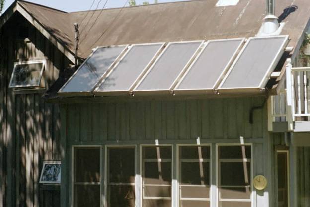

Large overhangs supporting a solar domestic hot water collector array which probably adds about 7 lbs per square foot additional load.
