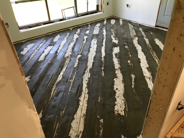

3/8th tubing use is not recommended. Most use 1/2 inch with 200' lengths being the max. We also like to keep the tube spacing in concrete to less then 1 foot apart. This gives you 1 foot of tubing per square foot. 3/8 will require to run substantially shorter tubing runs before the water is to cold to be useful. You also stated to put the tubing between cutup plywood. You need away to spread the heat evenly or you will have tons of warm and cold spots. A couple options are to use aluminum plates (expensive) but most of us now are putting tubing down and then laying at least 1-1/2 inches of concrete over the tubing which is by far the cheapest. There are other options. Hope everything turns out for you. The key to get info out to this site is to ask lost of questions, just not all at once. And of coarse search. You can search this site by using google and just adding greenbuildingtalk into you search string. |

I plan on using concrete ,...well actually grfc structural mortar in between the plywood strips. My plan for 3/8ths was I do not need 300 foot runs and my BTU load is soo low, 3/8ths puts out more than enough BTU in my application.
I also plan to install ceramic on top of it...…..its a 2 fold attack, by reducing the concrete needed with plywood strips it allows less structure to support the weight and the ceramic will further help radiate and give a bit more heat sink effect.
I am working in a 900 square foot total first floor, so the rooms are pretty small and the .5 story upstairs I am not even going to worry about, I will have I plan on a heat pump A/C unit up there, when people are up there,....which will probably be close to never. |

I would keep all wood based products out of this mix. I would substitute a tile backer board for the OSB. |
