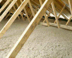

When they're done blowing the attic it should look fairly planar & smooth on the top surface of the cellulose, not huge waves or lumps:  http://t0.gstatic.com/images?q=tbn:...TUFFw_u1DA
