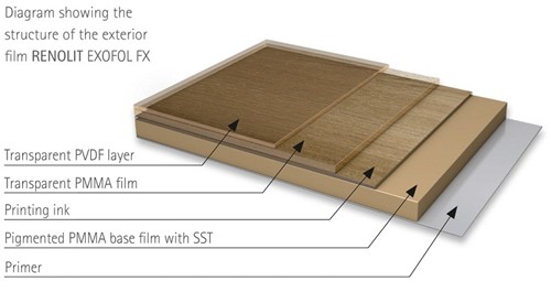

The vinyl windows are NOT just limited to UV inhibitors. They can install the RENOLIT EXOFOL FX over the uPVC at the factory which consists of 3 layers. The top layer consists of a polyvinylidene fluoride film, the second is transparent polymethylmethacrylate (PMMA) and the base layer is a solid colour PMMA. The base layer contains Solar Shield Technology (SST), to further decrease heat build-up of the film and the laminated components, including radiation damage. The three-layered structure of the film retains any color nearly without change throughout the service life, even when subjected to intense UV exposure.
