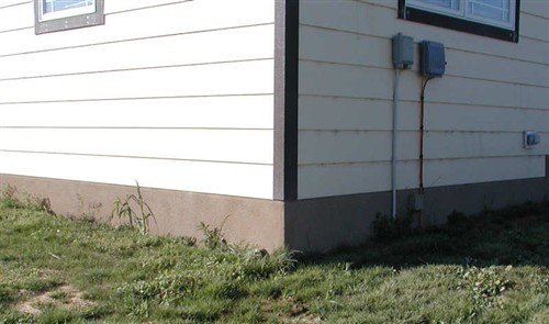

I also used it to make ledges that went above fake stone work to keep rain water from going behind the stones. They're 2" blue board covered with Tuff II. The stone mason who mortared the stones in place for me said it was one of the best ledges he'd ever seen. Here's a pic.
11 Jun 2012 12:21 AM
Here's a pic of it after the siding was installed.
