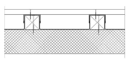

I would do a combination of what Jeff and Chris had mentioned. For long term durability and water-tightness you don't want to walk directly on the panels, but instead suspend a conventional deck above the SIPs on sleepers (beams that lay on the roof) and then apply a waterproof membrane between the sleepers that laps up the sides of the sleepers and then apply sheetmetal caps over the sleepers to make them and the membrane watertight and then apply your decking over that. Here's a diagram of the basic concept.

Simon,
Why not just lay a larger piece of the waterproof membrane over the sleepers in lieu of the sheetmetal caps?

Wes,
I was thinking that it would be hard to make one large membrane sheet conform to all the undulations the sleepers would create and there would be a possibility of puncturing it on the upper corners of the sleepers. So, for practical installation purposes, it should be divided up into smaller sections that only have to make one U shape each. The sheet metal caps will keep their shape and hold the membrane to the sides of the sleepers if they should come unglued.

18 Aug 2011 07:07 PM
A fiberglass deck system like the one Chris linked to will work, but is installation sensitive being that it is a coating process that must be applied properly. Not sure how long they last. Fiberglass is rigid and can develop stress cracks and allow water to get in.
My sleeper system relies on it's geometry to stay watertight by creating channels to shed the water. The deck above shields the flexible membrane from the sun, hail, foot traffic, etc... and will move with the expansion and contraction of the roof. It's a longer term solution.
