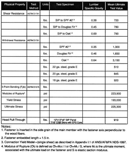

Ok Jelly, didn't want to leave you hanging.
SIP Fastener Design Criteria
Building Designer PANELfusion, LLC Tampa, FL [email protected] "Metal SIP Advocate"
Posts:2740
10 Dec 2011 03:17 AM
Posted By SimonD on 10 Dec 2011 01:15 AM
Thanks Simon!
1-So with the above setup, one would meet 140MPH wind/hurricane codes?
2-From what I read, it appears that these screws are needed every 6" OC?
3-How does one make sure that the screw is at the proper angle? (It appears that any deviation from the exact angle would make the screw miss the top plate.)
4-The ICF has to be poured and shaped at a certain angle in order for the SIP to lay across the ICF wall properly. How does one figure the angle and when is it created, during the pour or after?
