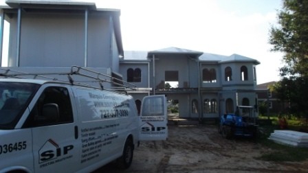

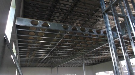

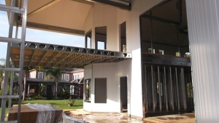

Chris nice work keep the pictures coming.
