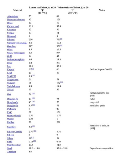

100+ Tips for Building with Metal SIPs find it on Kindle. Here are some more excerpts from the chapter on Specification & Properties. 20. Every 10 feet of panel length expands as much a 1/16th inch in moderate temperature differentials.
So how much would an EPS steel skinned SIP expand, that sees a 30 degree temperature differential in less than 15 hours???
02 May 2012 07:08 PM
I gleaned this piece of information from a sheet metal expansion table in a SMACNA manual years ago. I do not have access to one. I would think it would be about the same. If it were more it would be very little more. Thermal expansion as it relates to steel faced panels is generall not a problem. On the other hand aluminum faced SIPs have twice the expansion rate of steel and can be a problem. A 20' Aluminum faced SIP could move 1/4 inch. That is enough to break weather seals and pull out fasteners.
03 May 2012 07:21 AM
Steel's thermal expansion is about the same as concrete, aluminum is double that of steel
All materials have expansion rates but that is why I believe a steel SIP is far better than an aluminum SIP. Wood also expands and contracts with temperatures and humidity. Even window glass moves with temperatures.

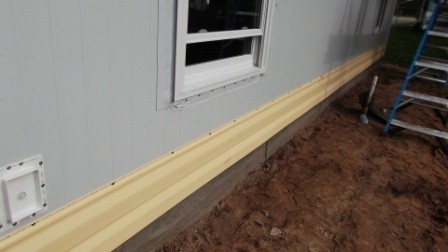

This home currently being built in Land O Lakes, FL. demonstrates siding being applied directly skin used as vapor barrier
r.
