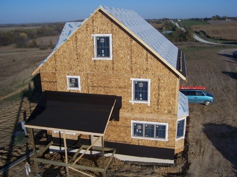

Hello again,
Was just reading on another site where they've found insulation unnecessary if there's a drywalled ceiling below.  My floor joists are ll 7/8 TJI's with 1/2" sheetrock ceilings applied below.
Any thoughts?  (SIP house, ICF foundation,  Spray foam on all rim joist and roof deck)
Ben
