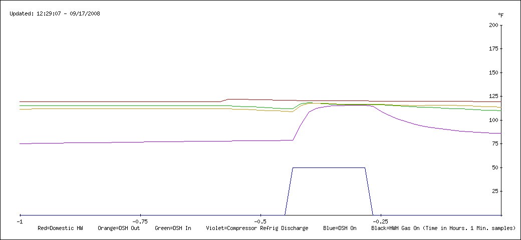

I'm in the process of turning back on my DSH that's connected directly to a gas-fired HWH, along with creating some meaningful charts to illustrate the challenges of not having a pre-heat tank.  Now's a good time to do this because, for my climate, we're still running in cooling mode, but it won't be long where a little bit of heating will kick in.
We'll learn from data and fact.
I'll report back here when I can show obvious conclusion.  Look at http://welserver.com/WEL0043/ for the work in progress (already in process of changing my charts that show measurement of R410A gas discharge temp).

Here's some preliminary data:
Water-to-air R410A GSHP, direct connected to gas-fired HWH.
Lines:
  • Red = hot water measured immediately after exiting HWH
  • Violet = compressor R410A refrigerant measured immediately after exiting compressor
  • Green = hot water from HWH into DSH, measured at GSHP entrance
  • Orage = hot water from DSH to HWH, measured at GSHP exit
  • Blue = DSH (GSHP) on/off
More data is at http://welserver.com/WEL0043/ .
I'll need to see some more cycles before I'm ready to offer observations / conclusions.
Let me know of any mods/improvements to the chart you'd like to see.
Posts:582
09/17/2008 5:54 PM
That warm green line (and somewhat cooler orange line) suggests to me continuous loss of heat from HWH into DSH (and thus GSHP) whenever GSHP not running.
Why is green always relatively warm even when GSHP off? Is DSH circ pump running continuously? That would not be good. Cause could also be natural convection.
