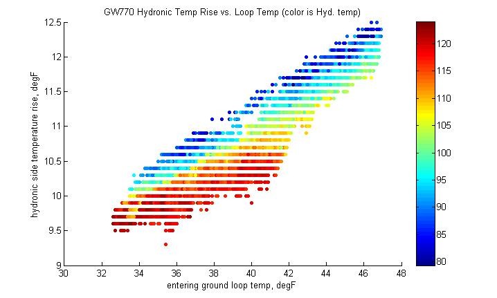

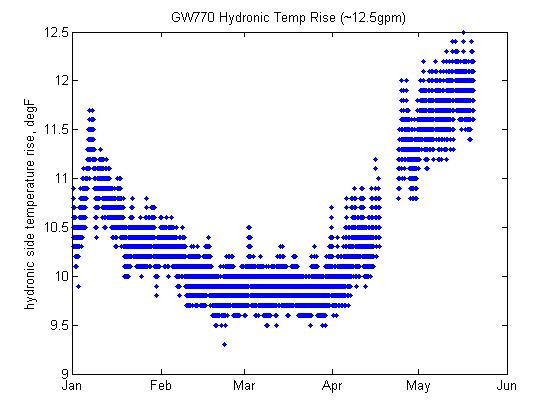

Rob, the temp rise or heating capacity should be available in the manufacturer's literature. Generally the flow rate is pretty constant, especially if you're using a buffer tank, so the temp rise is just capacity divided by flow. You should be able to get a reasonable estimate of flow from the manufacturer's pressure drop tables (I know in your case you'll be actually sizing the pumps properly rather than slapping the recommended # of 26-116s on!).
Assuming the flow is constant, the temp rise is proportional to the heating capacity which varies both with loop temp and hydronic temp. Here are 2 plots from my system - temperature rise vs time over the last few months and temperature rise vs loop and hydronic temps - you can get an idea of how much it varies. From what I've seen 10-15deg seems to be the industry norm.

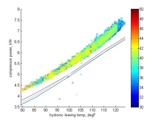

05/27/2008 10:12 AM
Actually, the power consumption of the compressor varies a great deal. For a hydronic unit there is very little dependency on loop temperature, but a strong dependence on hydronic temperature - going from 85F to 125F leaving temp can almost double the load. So as the hydronic temp rises, the capacity declines and the power consumption increases, so the effect on COP is multiplied.

It always has to be complicated heh... what are the different plots on that compressor power graph? I get that the colored dots are ground loop temps, what are the lines under that?

05/27/2008 10:48 AM
Sorry, should have labeled that better, I just grabbed an old plot. The soild lines are the power spec from the manufacturer at different loop temps - as you can see my unit draws more power than it should, but that is a topic for another time. Mainly I just wanted to show the variation in power with temperature. Most manufacturers have this data available in their specs (and if they don't they should, imo).
