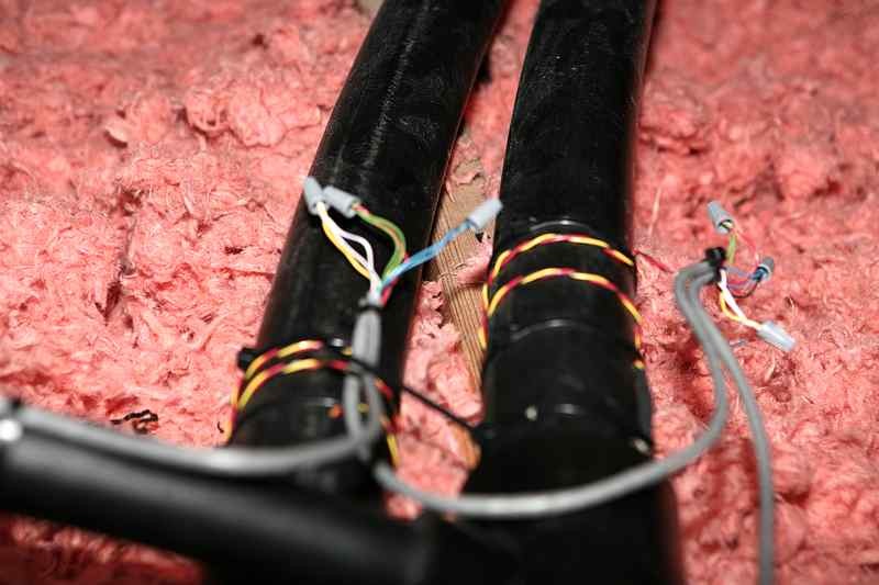

Dewayne, you're going to hook up 1-wire technology sensors to what I call a '1-wire network cable,' regardless of what kind of sensor it is (raw temp sensors, RTP sensors, RH sensors, etc.).
You'll locate your WEL at a place where it's easy to make a network (Ethernet) connection.
From the WEL, you'll have a '1-wire network cable' travel to wherever your sensors are.
Ideally you'll maintain a 'linear topology' - one '1-wire network cable' traveling around to sensor locations, with each sensor 'pigtailed' to the cable, with about at least a foot of distance along the '1-wire network cable' between sensor splices.
(The WEL's 1-wire interface is exceptionally tolerant of cable noise, though, and thus offers good accommodation of a '1-wre network cable' branch.  Make this your second choice, though, if you end up with a lot of sensors, or with long cable distances.)
The actual material for the '1-wire network cable' can range from CAT5 to simply a couple of 'bell wires.'  Generally you're only going to need 2 wires - signal and ground (RH sensors being the exception, where a 3rd wire is needed).  CAT5 cable will offer the best noise immunity - important, though, only in cases where there's a lot of sensors, or where there's a lot of distance to the sensors.  If using CAT5 cable, only 1 of the 4 wire pairs is used (generally).
For the RTP sensors, you'll need to have your '1-wire network cable' within 12 feet proximity.  Simply splice the RTP sensor wires as a 'pigtail' to the '1-wire network cable.'  I use small wirenuts to ensure a solid, mechanical, no-future-problems connection.  This splice connection will need to be someplace environmentally shielded (hence my earlier comment that only getting 12' of teflon cable could be a limiting factor, although you could purchase a spool of the Belden teflon cable to extend out the distance to sensor locations, with waterproof splice connections).
The image below is an example of a sensor connection to my '1-wire network cable.'  It was a first attempt to measure my EWT and LWT.
The gray cable is the CAT5 '1-wire network cable.'  A temp sensor is glued and mechanically fastened to the 2" HDPE pipe, and then is 'pigtailed' to the '1-wire network cable.'  Then, down a foot or so on the '1-wire network cable,' another temp sensor is 'pigtailed' to it.
It's actually more complicated to describe than it is to do it.  It isn't more than a 5 minute job to make the connection.
