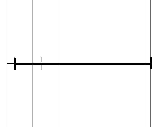

If you use TF in the way you're considering, you may want to use the next larger size of I-beams and put the extra foam INSIDE the wall.  That way, the I-beams hold the wall together and you have easy attachment points for wire mesh, strapping, or whatever.   I've tried to attach a drawing of what I'm talking about.
