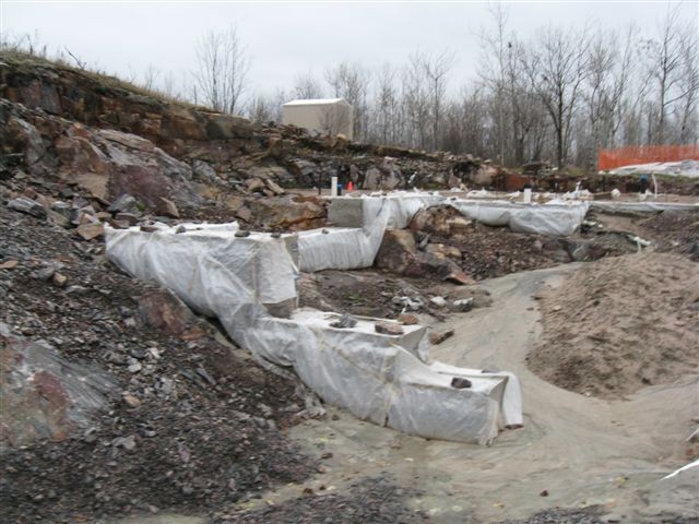

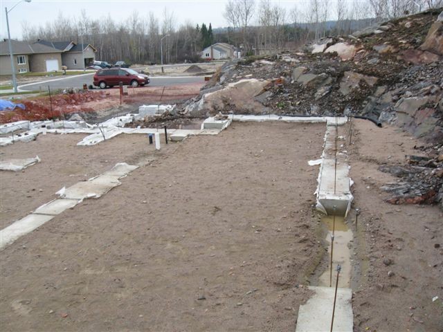

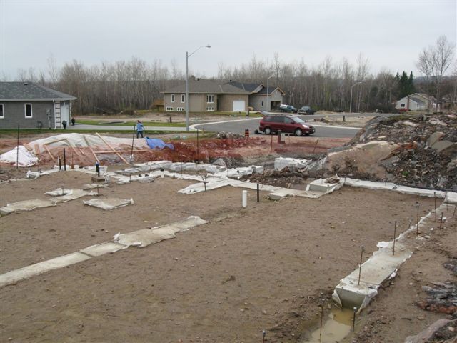

Our Northern Ontario building lot is basically a granite hill. We were able to excavate with a hydraulic hammer and some blasting but basically the only soil we have is what we scraped off the surface and relocated to the back of our lot.
Our house will have a walk-out basement and is nestled behind the hill that was left after the excavation. As a result, the south and west walls are above grade while the north and east walls are half below grade. Also, it will be ICF to the rafters and we are backfilling between the house walls and the rock.
We are designing the windows for passive solar heating due to our exposure to due south at the back. Also, we have an HVAC specialist developing our heat load calculations.
Is geothermal even a consideration in this situation? If so, what would be the best design and installation approach?
