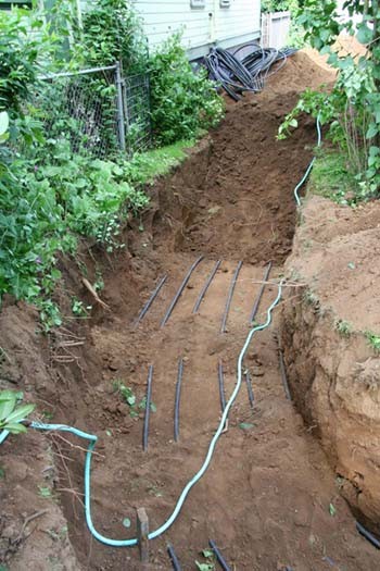

We were referred to a contractor who has done a lot of horizontal closed loop installations and have gotten a new perspective on slinky loops.  Of the three local contractors I’ve now talked with, this is the first who expressed willingness to give us pointers on our DIY pipe trenching, sell us the best pipe at a reasonable price, fuse our pipes to the collection heads, and pressure test before and after backfill.
This contractor does not do slinky loops and advises against them for four reasons.
  1. There is an inherent conflict in sending a pipe that is slowly absorbing heat backwards onto its previous path where it could lose heat to the colder pipe/soil behind.
  2. Backfilling and soil compaction is easier with less risk of one pipe crushing the one below.
  3. Multiple pipes can be placed in multiple lifts increasing the volume of soil contacted.
  4. Straight run pipe installation is all-around easier than loops.
They are not suggesting decreasing the total linear feet of pipe, just running more single pipes per trench.
Again, not knowing the physics of how the number of pipes affects head pressure and resulting pump size, I’m assuming it takes no more energy to run twice as many same diameter pipes a shorter distance?
As to the concerns about freezing soil I posed in another post (see my post “Best loop tubing?” and Cnygeo’s informative reply):  The contractor has never designed a water based system that had loop temperatures that dropped below freezing and thinks that such low temperatures indicate poor design – the efficiency of the system depends on water temperature, and in our mild climate, at the point of below freezing loops, you’re better off with an air-source heat pump.  They saw no real problem running a portion of the piping around the foundation perimeter, especially with our well insulated foundation.
Our modified design would have (8) 350’ loops – 340’ of individual trenches away from the house, and an additional 175’ of trench around the foundation perimeter.  No one has done any calculations of this layout, but our thinking is that it is the equivalent of 280’ of slinky trenches, just with some of the pipes spread out over a greater volume of the available soil.  Since we are replacing the existing house’s foundation, the loops near the foundation are just a bonus taking very little extra effort.   Soil placement during loop trench excavation is our only real logistical challenge, and that is why some of the trenches are only 32” wide.
If anyone has any advice on our latest scheme, we welcome all opinions.  In the attached PDF, I've included the slinky loop scheme GeoDean commented on previously.   Also, is anyone aware of documented cases of water based geoloops freezing the soil and damaging foundations?

Thanks Cnygeo, Geodan, and others for your previous feedback.
Since my last posting, I visited a job site were the local contractor who had looked at our plans and given us feedback was installing a horizontal system in a 5’x5’ trench 500’ long with (6) ¾” pipes at the bottom.  He invited the public out to see an installation first hand and give advice and answer questions.  I had told him right from our first interaction that we were looking to install the system DIY and that we would not be a potential client (except for the heat pump which we would only have a professional install), and this did not concern him.  Seems like a great guy who has a keen interest in promoting geothermal.  He advised us on how to make the system better, told us to base it on 3-tons of heating (not 2.5), and said our system would never get below freezing as designed. We revised our design and emailed the plans back to him but have not heard from him either responding to email or phone messages for two weeks – very busy guy, so I don’t begrudge him one bit, the advice was free after all.  The system will now have (6) 375’ ¾” pipes at 5’ deep.  The 5’ wide trenches are 295’ in length, and the 3’ wide sections next to the foundation are 80’ – see attached diagram.
We are scheduled to have the excavator come out on Wednesday and will lay the pipe perimeter pipe in one day.  The sections next to foundation and under the addition will be done later when we replace the foundation.  We will bury the unsed portions of coils under some plywood to keep them safe until we are get to the foundation excavation.
Does anyone out there see any problems with our system or think we should change pipe size or number.  We where originally thinking we would place eight pipes in at least two lifts, but after talking with the above mentioned contractor and our excavator (and seeing an actual installation in the pouring rain!), we decided that placing all the pipe just at the bottom of a wide trench was the best way to go.  The excavator will start by digging a short (30’ to 40’ to start with, shorter 20’ lengths after that) length of the trench with a backhoe, we will lay that section of pipe, he will use a bobcat to take the excavated soil all the way around the house and begin backfilling behind us.  We’ll work our way gradually around the house to keep temporary soil placement to minimum.

Given the small lot that you have to work with, I would say that you have a pretty good plan in place.
Be very careful about the loop temp. The water leaving the heat pump can be as much as 10 degrees colder than the water coming in. So if the water coming from the ground gets down to 42 F you are in danger of freezing the coil inside your heat pump. This pretty much ruins your heat pump.
Methanol is not that expensive. There is no way I would install a system with out antifreeze. Since you don't have a lot ground area to work with, your loop temps might get colder than you think.
Please keep us informed as your project gets going.

Second what Geodean says about antifreeze - if you're going without make sure you have at least a few degrees safety factor and MONITOR the water temp going out to the loop. You could always start without antifreeze and if the outgoing temps start dropping too much for comfort you could add it. Of course the cost and difficulty of doing this in the middle of the winter could be great depending on your system! Open loop systems use various freeze-protection devices (refrigerant pressure and/or outgoing water temp switches) so you could look into adding these as well.
In terms of your loop design, my gut says that it is pretty dense - lots of pipe without a lot of surface area. But, you're on the other side of the country from me in a different climate and with different soil, so I'll defer to local experience here. It doesn't look like you have a lot of options to expand anyway!

We have finished installing the outer perimeter of piping of our horizontal loops.  Most of the job went well though it took twice as long as the excavator first said it might take – 20+ hours for the excavating.
 Two pipe questions:
1.  The pipe would get twisted when rolling it out, and that twist would sort of curl up and poke out of the coil – I started calling these hernias.  The solution was simple, just flip the entire coil until the twist unwound, and the problem would fix itself.  One time during the job the excavator was moving the coils when he perceived things weren’t going fast enough, and I had to insist that he leave the pipe laying to me.  At the very end of the job, once again the excavator decided to “help” with the coils again and one of the coils developed one of the hernias projecting from the coil and the twist developed a crimp while he was pulling on it. The pipe now has a slight indent at the crease line and is lighter in color.  All of the pipes are under 80-lbs of pressure, and that pipe appears to have no leak when soaked at the crimp. This last section is not yet buried.
The question is, does this compromise the pipe -- should it be repaired or protected in any way?
I have told the excavator that if the pipe needs to be repaired, he must pay for it. The contractor insist that kinks do not hurt the pipe and that he is in no way responsible for damage to my piping under any circumstances (he did not see that he had crimped the pipe until I saw it later.)
2.  The excavator was pulling dirt back along the bottom of the trench with the track hoe after the pipe had been laid, and he was allowing the bucket blade to ride along the tops of the pipes -- pulling dirt off the pipes. The bucked had a rounded blade edge and no teeth.  When I saw this, I insisted he not do it any more.  He says he does it all the time with water piping, and all these pipes are so strong that he could never hurt them with his bucket.  The pipe had obvious scratch marks running parallel with the pipe.  None of them looked very deep.  What I couldn’t see was any potential damage at places that had already been buried where he might have been doing this.  One of the pipes has lost about 3-lbs of pressure in 16hrs.  Not sure wether it is coming from the manifold or plug at the ends yet, but I’m now a little worried.  My question is, would even a small leak make the pipe unusable?

esger.
Ref question 1:  What kind of pipe did you use?  Was it HDPE (High Density Polyethylene) or cross-link polyethylene pex-a, pex-b, or pex-c?  Whether permanent damage is done when the pipe is kinked oftentimes depends upon the type or material in the pipe.  Sometimes damage will not show up for several years.  It is best not to kink any type of pipe.
Ref question 2:  In my humble opinion, the bucket blade should never touch any type of plastic pipe.  Why take the chance of damaging pipe that will be covered that deep?  I think you should monitor the pressure in the line that shows a loss of pressure.  If the pressure keeps dropping then try to check the easiest things first.
