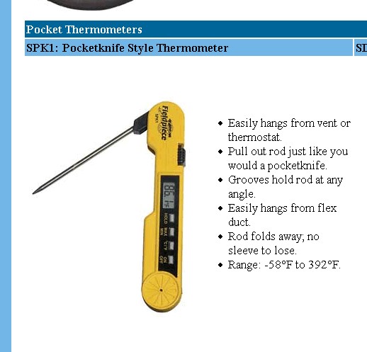

All you guys who are having cooling problems,  you need to find out what the loop temperature is coming out of the ground.  Your system should have a P/T port where you can insert a thermometer and check the temperature of the water coming out of the ground.  You can buy a thermometer from Fieldpiece called a pocketknife style thermometer.  If your loop is above 90°,  then your heat pump won't work.
If the ground is really dry,  then the heat transfer from the pipe to the ground is severely limited.  The first thing I would do is soak the ground.  Don't wait for rain.  Moist ground conducts heat far better than dry ground.
If the ground is moist and the loop temp is still high,  then your system is short looped.  You need more pipe in the ground to dissipate the heat.
Soaking the ground will only work on a horizontal system.  For a verticle system, your only option is to install more pipe in the ground, or install some kind of fluid cooler.

Thanks - I'll get one of the themometers - loop length should be fine - never had a problem under normal conditions (normal being blistering heat in the summer) but this season is being ranked as a "100 year drought" with severe heat.  I'll try soaking the ground - I have an irrigation system that I can run that covers the area of the loop - just have to do it at night since we have water bans on.
