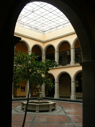

I have seen in another post of yours, you have family in Mexico. I have traveled to central Mex, Irapuato, Gto, many times. The construction methods and style is what inspired me to build ICF. We are building a hacienda style with an open area that the rooms over look.
Attached is a photo of the style we are using
