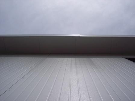

finish is as shown in picture attached

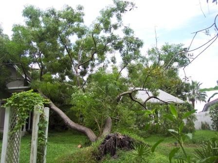

What about Hail in general or storm damage to steel SIPS? Can dents be fixed or perhaps a branch makes a tear in the sip? How are they fixed? How susceptible are steel SIPS to being dented by hail?

Posted By slenzen on 07/18/2008 12:00 PM
Thanks Chris, you offer a lot of great info and are an asset to this forum.

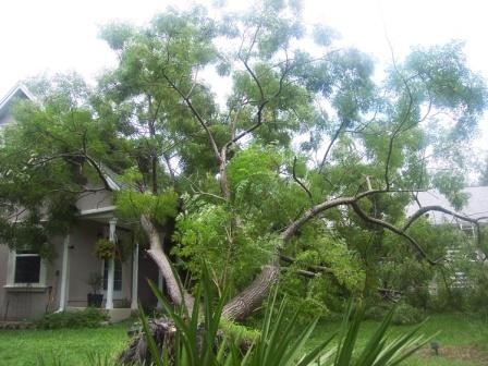

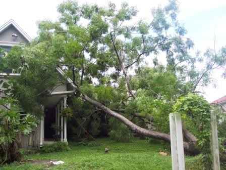

Slenzen;
like this tree that fell on my office Monday Morning? tree surgeon said roof was bearing most of the tree weight, after it was removed yesterday it sustained just minor shingle damage and one small skin puncture.
we will remove shingles and stitch a patch over area & re- shingle,
if we can cut 2ft x 4ft. skylights thru the roof, small punctures are insignificant and basically will not leak thru until repaired
I don't like to see the steel SIPs left exposed for aesthetic reasons, but would not expect any great hail damage as steel has solid foam backing and is resilient.
