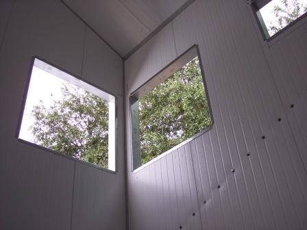

What about at the window and door openings? If the rough openings are lined with steel isn't there a thermal transfer possibility there?
Posts:861
08/03/2008 5:35 PM
Posted By Jelly on 08/03/2008 5:29 PM
jelly;
if you run the steel straight thru, but in extreme cold climates the window / door recievers are either thermally broken or 2 piece with gap, same as done for base or top channels. exterior wall corners are mitered so there is no thermal transfer

cmkavala, are you talking about the window or door frame as provided by the window/door manufacturer, or about the framing put into the rough opening by the SIPs manufacturer?  I had been assuming that even steel SIPs use 2x lumber for framing rough openings, but perhaps I was wrong.
Posts:861
08/03/2008 6:02 PM
Posted By rnortman on 08/03/2008 5:41 PM
wood in steel SIPs, bite your tongue!
the attachment shows the channel used for steel sip walls, and 18 ga. "U" channel, no grooving necessary, it just simply wraps the opening and is effective for openings up to 6ft. wide, larger  - such as overhead door openings have another detail
The overhead door detail also serves as the top door buck, sides are done with 6" steel stud/track
The photo shows the window framing
Attachment: File0241.PDF
Attachment: OH door.PDF
