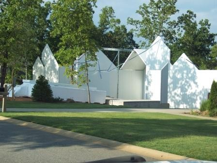

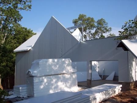

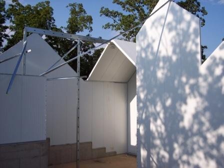

This 2 story with walk out basement is being done by owner/builder , balloon framed walls as tall as 35ft. Owner is doing a great job!
Roof is 10/12 pitch

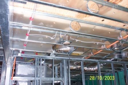

I just sent you an email, 2 nd floor is attached to inside skin of panel as shown on attachment
Attachment: joist connection.pdf

Chris- Thanks for the info you sent me- I sent you a reply. In that picture, it looks like the plywood subfloor is screwed directly to the metal joists? FWIW, my porches all have a 10' free span with a 4/12 pitch- is that too much for a roof SIP without additional framing? I think the snow load in my area of SC is 10 or 15 pounds. Since we will be on the porches a LOT, I like the idea of an insulated roof. In one house, we had a porch roof made of aluminum roofing pans. After a couple of years, we added foam insulation- what a difference! It was also a lot quieter in the rain. Another question- what kind of span can those metal joists handle- say for a 30# live load, as in an upstairs room?

the plywood is glued & screwed or fastened with balistic nails shot with a pnuematic nail gun capable of penetrating 14 ga. steel
a 6" Steel SIP @ 10 ft clear span is rated at 105 lb. total load
The deitrich "Trade Ready" steel joist system is cabable of clear spanning 32 ft., size , ga. & spacing depends on span/load
