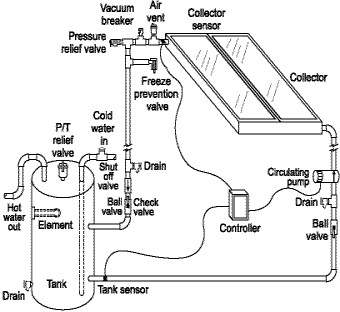

P
It is expensive and a little complicated to set up at first because of the need for heat exchangers, pu and learning.
It really is not that expensive to make adn set up.  If I atttached a copy of the system diagram successfuly you wil see that anyone with enough guts to build their own house can handle this pretty well.  You can build your own solar panel getting most of the stuff needed from your  local house builders dumpster.  I can e-mail directions for construction of a solar collecter is anyone wants.
rnortmanUser is Offline
Posts:97
08/01/2008 7:44 PM
That setup in the diagram doesn't include a heat exchanger.  This means that your drinking water flows through the solar hot water heater.  I have never set one up myself, but I've seen the setups, and my understanding is that it's a good idea to put antifreeze (I think just glycerin) in the water that goes up to the roof, at least in a cold climate.  This is a closed-loop type of system, where the water just recirculates continuously.  You get the heat out with a water-to-water heat exchanger, as I mentioned above.  But even with that extra complexity, it's not so bad that you need an engineering degree to make it work.  Add in hydronic heating and things get a little more complicated, if you want to use the solar hot water for heating up both the floor heat water and also the domestic hot water.
Posts:97
08/01/2008 7:48 PM
Wikipedia has some good information on the different types of solar hot water, including links to the DIY community: http://en.wikipedia.org/wiki/Solar_hot_water
Posts:97
08/01/2008 7:56 PM
Sorry to be making so many separate replies, but here's an even better page explaining the different ways to do it (open loop, closed loop, etc.):
http://www.homepower.com/basics/hotwater/
DonaldsonUser is Offline
Posts:92
08/01/2008 8:09 PM
The system described in my post is being used in Camdenton Mo. with 10,000 square feet of panels. It heats radiant heating water in a closed system with anti freeze. But it also heats the potable hot water for a training center that houses over 300 staff and students. The snow and cold do happen and sometimes with extreme long periods of of below 20 temps the system is drained and we go on fall back conventional system. but for almost 350 days of the year it is all solar hot water.
