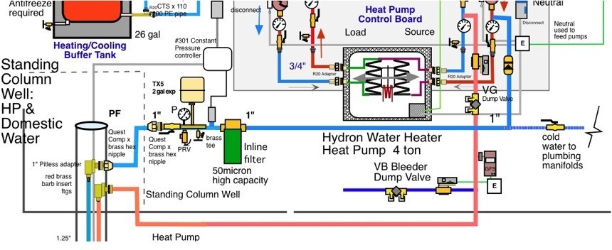

We will likely be adding a SCW to our 400+' potable water well this Fall.  The proposal from the contractor includes a constant pressure pump control valve (or cycle stop valve).  Here's one company's website: valves
I do not know if he plans on using this comapany.
Here is a part of the diagram of the system he has designed.  As the system is intstalled, I'll have more information.

Looks like you've got a nice system allowing you to get domestic water for free (it already was used for the heat pump). The diagram shows that your new well pump will be variable speed, controlled by the Constant Pressure Controller shown. The only thing not shown on the diagram is how the pressure system works, can the pump speed be controlled to give you 50 PSI when you're using domestic water and only 30 PSI when just the heat pump is running?

Actually, this is a retrofit and the domestic well is already in use.  We will be "turning it into" a SCW with a geothermal heat pump this Fall.  As far as I know and understand the system, the pressure controller (CSV) will control the pressure to the heat pump and domestic water.

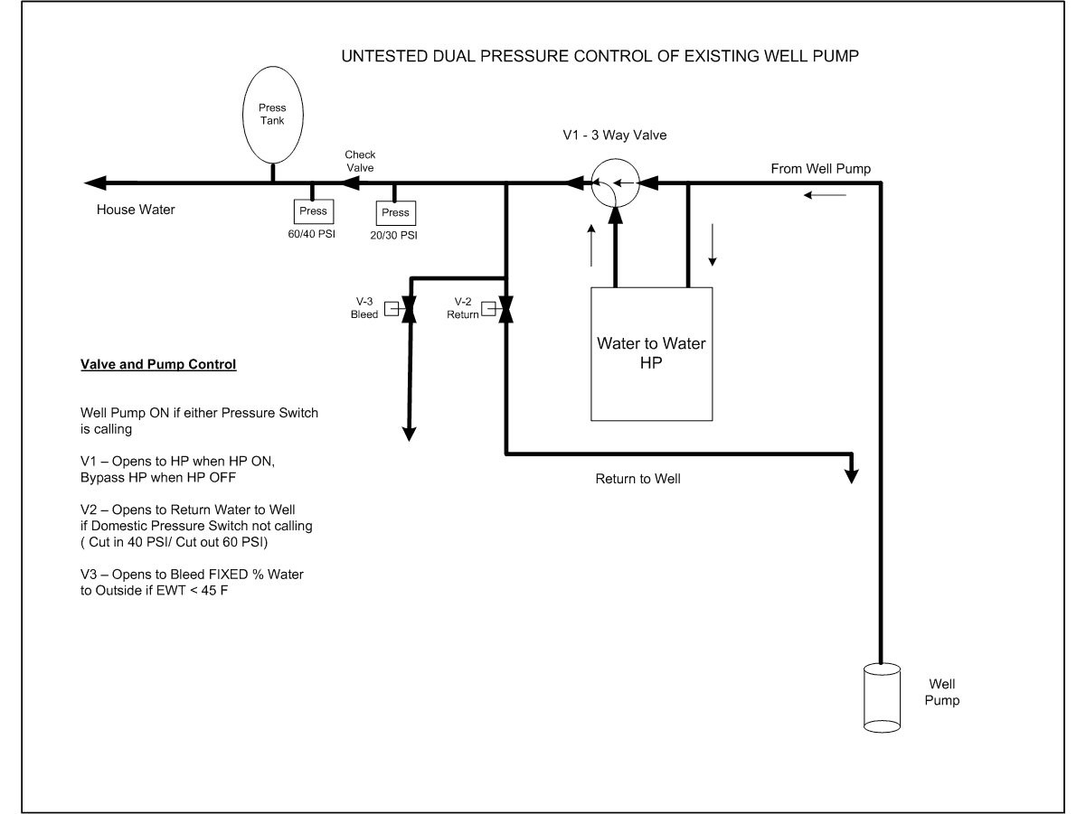

I liked that drawing so much that, "just for fun," I tried to sketch out how my existing well pump might be used for both domestic water and a heat pump (standing column well) without having to add the domestic GPM (6 GPM) and heat pump GPM (6 GPM) requirements.  6 GPM total from the Well pump should satisfy everything.
Maybe someone who's done something like this can comment...  Think the check valve seperating the hi and low pressure zones will work?

Re-reading Dick's orig post, I did same design as he suggests except my pump is not VFD controlled

Propanebegone, why is there the diverter valve V1 in your diagram? Why couldn't the water pass through the heat pump's exchanger all the time, with no temperature drop when the heat pump isn't running?
Second comment, why not locate the bleed valve (V3) it downstream of V2? That way, when the pump is running flow into the domestic tank and EWT is below the bleed cut-in temperature, the flow into the domestic tank constitutes the bleed. Valve V3 doesn't need to know if V2 is open or closed; it can be open whenever bleed is called for, even though there is no flow through it, simplifying interlocks. I am  assuming the bleed valve (V3) is sized to limit the flow relative to that returning to the well, and that pressure drops and static head changes of lines to bleed location and return to the well are such that the bleed flow is correct.
As to whether the check valve will hold pressure in the domestic system, my understanding of check valves is that after some time they may leak a bit. If this is a slow leak, it shouldn't matter, since an eventual drop of pressure in the domestic pressure tank will just turn on the pump and close V2 to bring pressure back up.
Repeating the remark in my opening post, it would be nice if someone out there who has actually plumbed things up somewhat like this would comment. Otherwise you'll be doing yours before mine, most likely, and I'll benefit from whatever you learn. We can call the arrangement the "PBG configuration," in your honor, unless it fails.

The 3 way valve, V1 is there for 2 reasons. 1. I have iron in water and if this is going to cause a build up, I'd rather limit the exposure to only the actual heat pump run hours. I'll learn by experience here. 2. I'm thinking the pressure drop of the heat pump may reduce my Domestic GPM, but I admit I haven't done any calcs based on pressure drop :).
Why not locate the bleed valve (V3) downstream of V2? You could certainly do this. I chose this configuration because I have only 4 GPM ground water recharge into my well. My thinking was, maybe I want to bleed 1 or 2 GPM overnight under cold well water conditions, while we're not use domestic water, to increase my well temp. If I put the valve where I've shown, I can bleed all night if desired, with or without the heat pump running. (wasn't that a springsteen song "Bleed it all night..."?)
In my case, I am planning to program a small logic controller to make the decisions. With the changes you mention, it would be easy to just use an ON/OFF control based on EWT, and this would work fine in many apps.
...Anyhow, the PBG config may not apply to all applications...
I am interested to hear from people who have done it, or as you say, they may be us soon.
