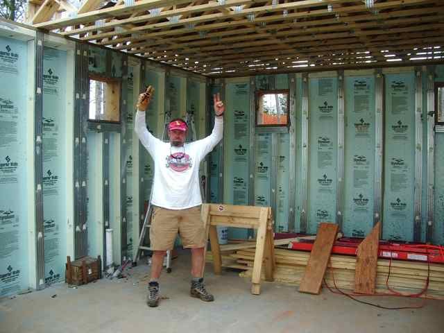

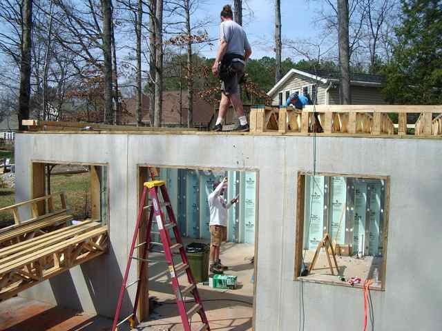

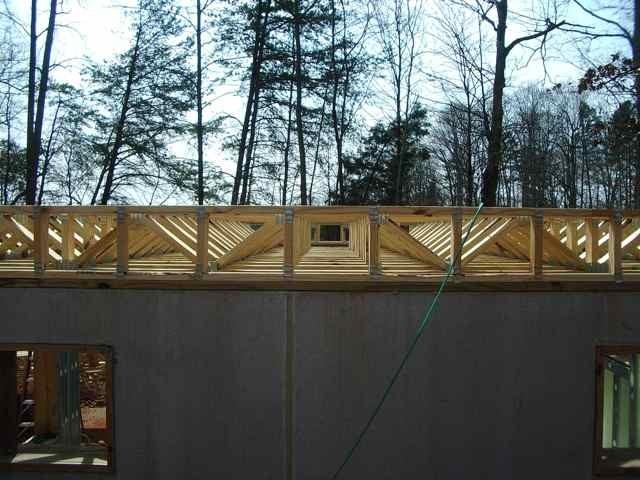

29 Mar 2009 04:08 PM
Here are some pictures of our project, called the "bomb shelter" by the inspector. We decked this with 3/4 huber advantec, so this past three days of downpour have hopefully had litle effect. Thanks for the responses, they are invaluable for a layman like me.
Attachment: setting trusses.jpg
Attachment: me in basement.jpg
Attachment: IMGP5105.jpg
