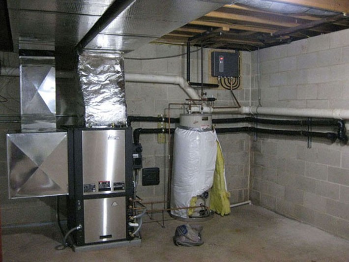

here is the setup
Attachment: geo.jpg

Up the flue in the center of the water heater. Cooler air is being drawn in the bottom and exhausted out of the top with a LOT of heat from the tank.
One thing from your photo. You need to have the supply and return hoses between the unit and the pump pack insulated, otherwise they will sweat.
Bergy

so all I have to do is somehow seal that center piece of the water heater and is good to go. Where is the pump pack you are talking about, the flow controller? you saying those those clear hose need to be insulated?

In the photo you can see two insulated lines coming through the wall and leading to the pump pack mounted on the wall.
You said the pipes were clear? What kind of pipe is it? As far as I know, the only flexable hose that should be used is a reinforced "radiator" type hose. If that is just a clear vinyl hose it might collapse. I would find out if this hose is recommended by the heat pump manufacturer. If not, have it replaced with the proper hose and insulate it.
Bergy

I'm pretty sure the house is radiator type hose that came with the unit by climatemaster, we actually had the climatemaster person from the company worked on the unit little bit and everything looks good. so all i have to do is insulate the hose?

Really? If it is the proper hose then insulate it. Why didn't your contractor do it?

DSH lines are generally insulated as well, but it is a nice looking install.

not sure why they didn't, but I'm going to insulate all the pipe and hose

I should mention that, like Bergy, I'm not familiar with a clear hose recommended by Climatemaster or anyone. Perhaps someone is familiar with these and can clear it up? Or perhaps the hose is labled and you could tell us what it is.

Its not a complete clear hose, I'm pretty sure its a reinforced radiator hose, it have line across the hose and its pretty thick. I'll go look at it when I get home.
