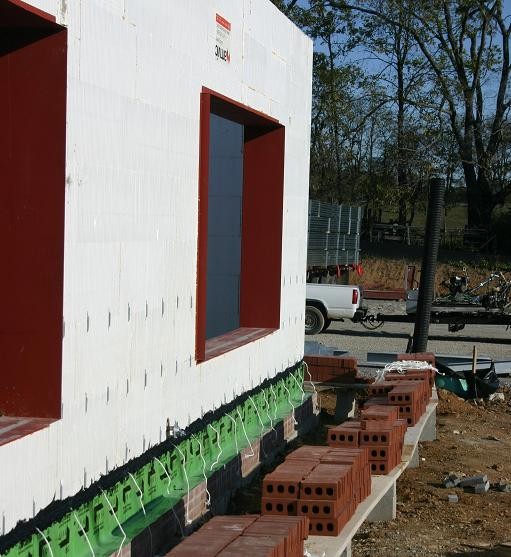

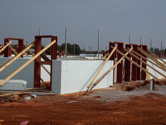

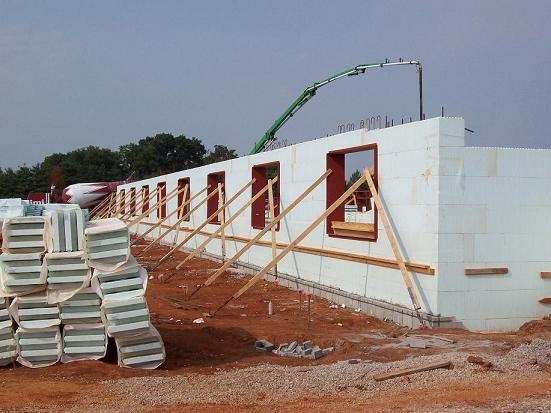

The current grade of Stala you can view below has been designed for heavy duty commercial construction. Typically, we are included on larger ICF jobs through working with the architectual deisgn teams and specified into plans. However, we are also available throughout the ICF community as a universal product for ICF projects. To realize Stala performace and reduction in materials, money, labor and time please contact us during the designing of the ICF structure.
We are attaching some interesting job site photos of our current school projects under construction 08/08.
*Note* All of these Stala Assembies are fabricated to coordinate the materials/trades beyond ICF wall construction. For example, we coordinate with Divison 8 to include hardware preperations to swing doors, another example is with drywallers, we have various details to eliminate drywall in jambs and corner guard at doors.

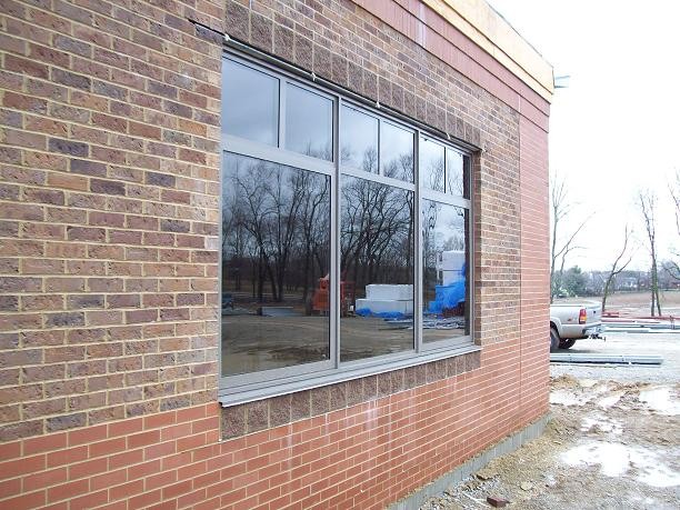

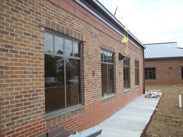

Hi Leonard-
We can incorporate any window door type into the Stala IFA.
I am attaching some typical exterior window pictures from some recent schools we have performed for.
As for trade shows let me get an updated list and post soon. We've been keeping pretty busy communicating with AIA and its members to specify Stala in commercial ICFs. However, we wish to keep the ICF community up to date with our advancements and help facilitate stronger, more efficient openings.
If there is any desire to come into Kentucky and meet with us, there are some amazing commercial ICFs that would be a better use of time than seeing samples at a trade show. The field performance of Stala is pretty amazing.
-David
