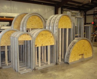

We just installed some of our arch topped steel window jambs in a TF Systems house in Florida in a round stair tower.  I haven't downloaded the pics yet but would be happy to send them to you.
Geoff
Attachment: JAMB-it-ALL waiting for their home1.jpg
