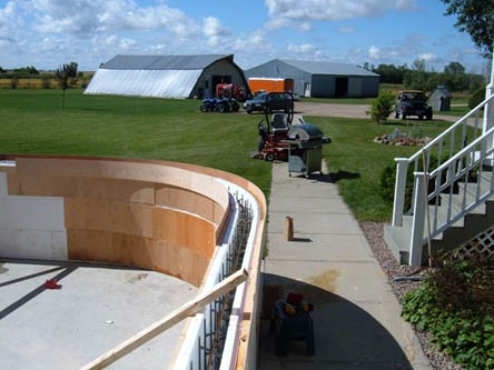

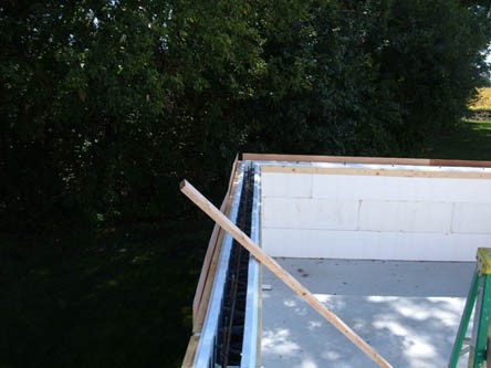

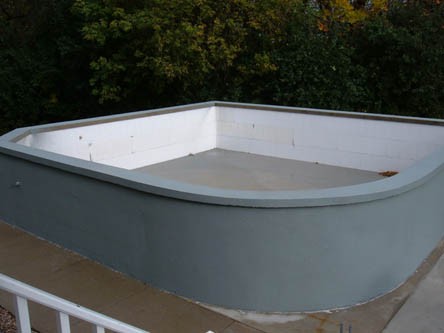

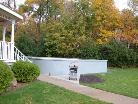

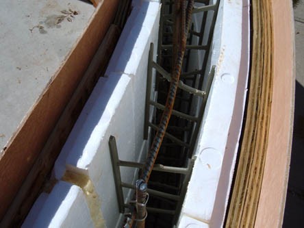

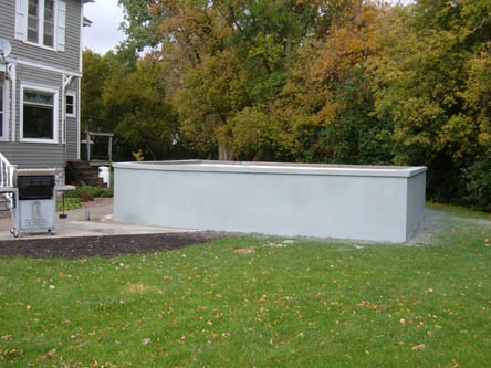

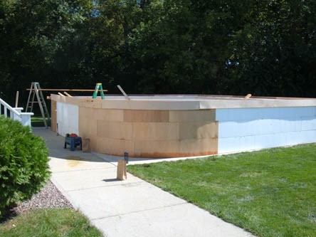

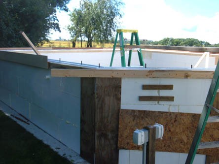

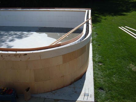

I have completed 3 pools now with ICF all 3 are above ground pools and have worked very well. Our own pool was the first one that we built, I would post pic's but have not been able to get that to work ( not a computer geek).
Our pools is 4' deep and 24 X 24 with a curved wall and a 45deg wall this is our 3rd or 4th year now with 15000 gallons of water and very happy grand children. When we fill the pool in the spring we have our local Culligan company bring out portable softner tanks hooked in a series ( we have 75 grain water ) our old rubber pool was filled with hard water and took most of the summer to clear up as well as $2500 in chemical, the soft water cost use $220 and $180 in chemical for the season.
Some of the reasons we went above ground where code and the fencining cost for saftey, we already had the slab to build off of,and we are in Minnesota so we drain it each fall any how.
We are planning on building an inground directly behind this one and that was scheduled to begin this year, but with the economic times have decided to put this off untill sales pickup.
Buy the way our estimates from a pool company where over $40,000 to build what we did and counting labor we have less than $6000 into this pool with the heater, filter and pump included.
I have sent pics via e-mail for anyone who would like and that seams to work.

JBmike I have tried to send pics through this web site but the files will not go , it seems to work if I send them out direct to your e-mail as I have with others.
28 Jun 2009 09:55 AM
Cattail Bill, you were nice enough to send me the pool pics several months ago. Would you mind if I posted them into this thread on your behalf? I have a computer geek license :)
Cattail BillUser is Offline
Posts:206
01 Jul 2009 06:28 PM
Absolutley you may post them!!!
01 Jul 2009 10:02 PM
Ok, these are pics of Cattail Bill's ICF pool:
Attachment: BillsPool1.jpg
Attachment: BillsPool2.jpg
Attachment: BillsPool3.jpg
three more pics:
Attachment: BillsPool4.jpg
Attachment: BillsPool5.jpg
Attachment: BillsPool6.jpg
