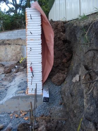

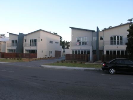

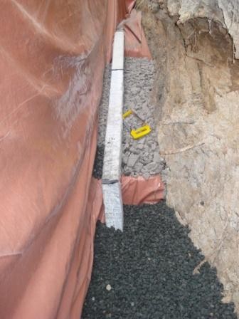

FC SteveUser is Offline
22 Jun 2009 11:31 AM
Sorry, wrong photos.
I meant to add these photos showing a retaining wall that has 40MPa concrete (6000Psi) with no paint on membrane on the footing, no Krystol or Penetron in the mix nor any waterstop just a plastic sheet loosely hanging behind the styrene and Atlantis drain pipe at the base and we haven't seen a drop come through the base of the wall.
Steve Krsticevic
FORMCRAFT
Concrete Homes Built for Life
Attachment: Picture 130b.jpg
Attachment: Picture 110b.jpg
